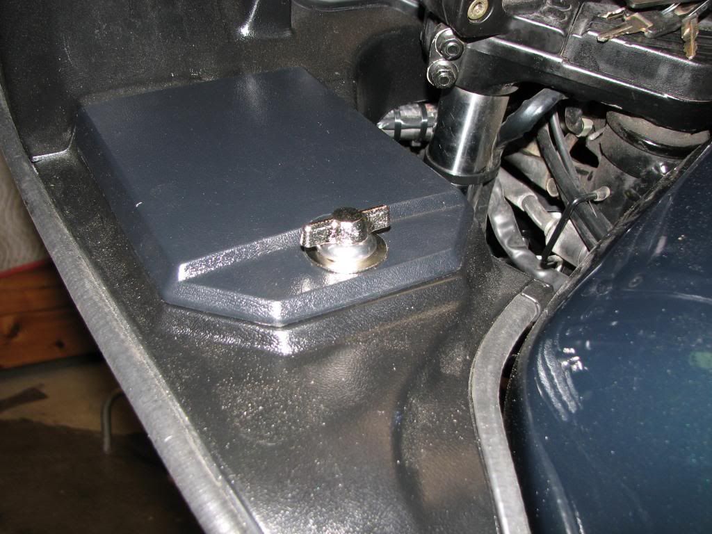

Here's what it looks like installed.  Not sure if it's the exact same one but looks close.  Came with my bike.

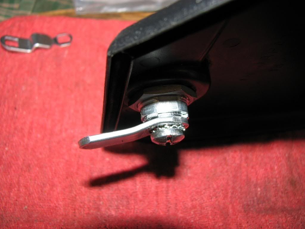

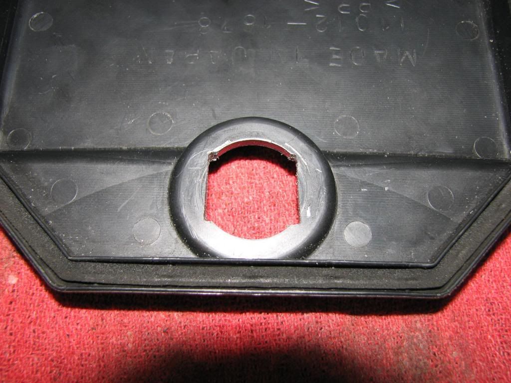

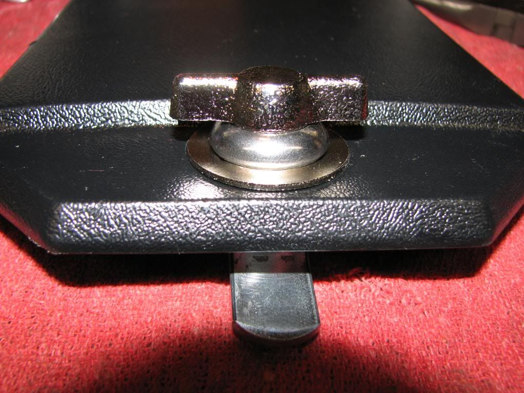

Time for pictures!!!!!!!!!!!!!!!
This one is from Grainger's as listed above - Cost under $8.00
This is what comes in the package.  The two parts on the right are not used.
I needed to widen the whole just a bit for the tabbed washer to fit.
I also had to bend (several times - trial and error) the straight tab to make it line up properly with the slot.
The tabbed washer fits nicely.  It sits a bit above the recess, but that's fine.  Can't really tell, plus it helps keep the knob elevated so it does not rub on the plastic.
What is really strange in the photos is.............   It looks like the pocket cover and the inner fairing are two different colors - and yet they are not.  In normal lighting, you cannot see a difference.  Not even a little bit!!    And everything was painted with Krylon Fusion for Plastic, Satin Black.
And there you have it!!!!!!!!!
