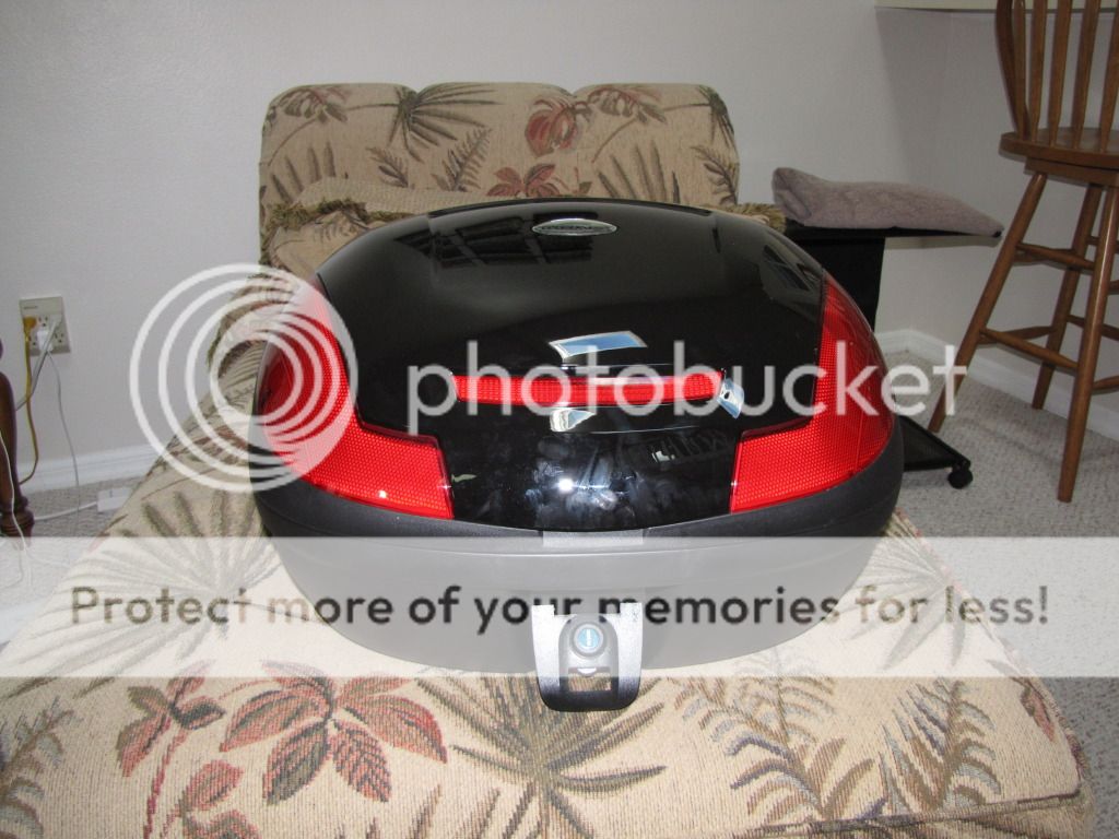

So, I bid the minimum on the top case, and who knew.... I won it... So now this:
will now have to go on the back of the Concours.  Once I get it here, I'll start working on fitting
and mounting.  I might have the wife make a backrest for it.... She'll thank herself for it later..lol.
$60 shipped.  I'm not complaining....   I have some LEDs I may be able to wire in.  New Projects!
The mounting plate on this box is metal, btw...  I was listening F-106!   :great:

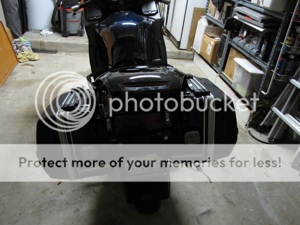

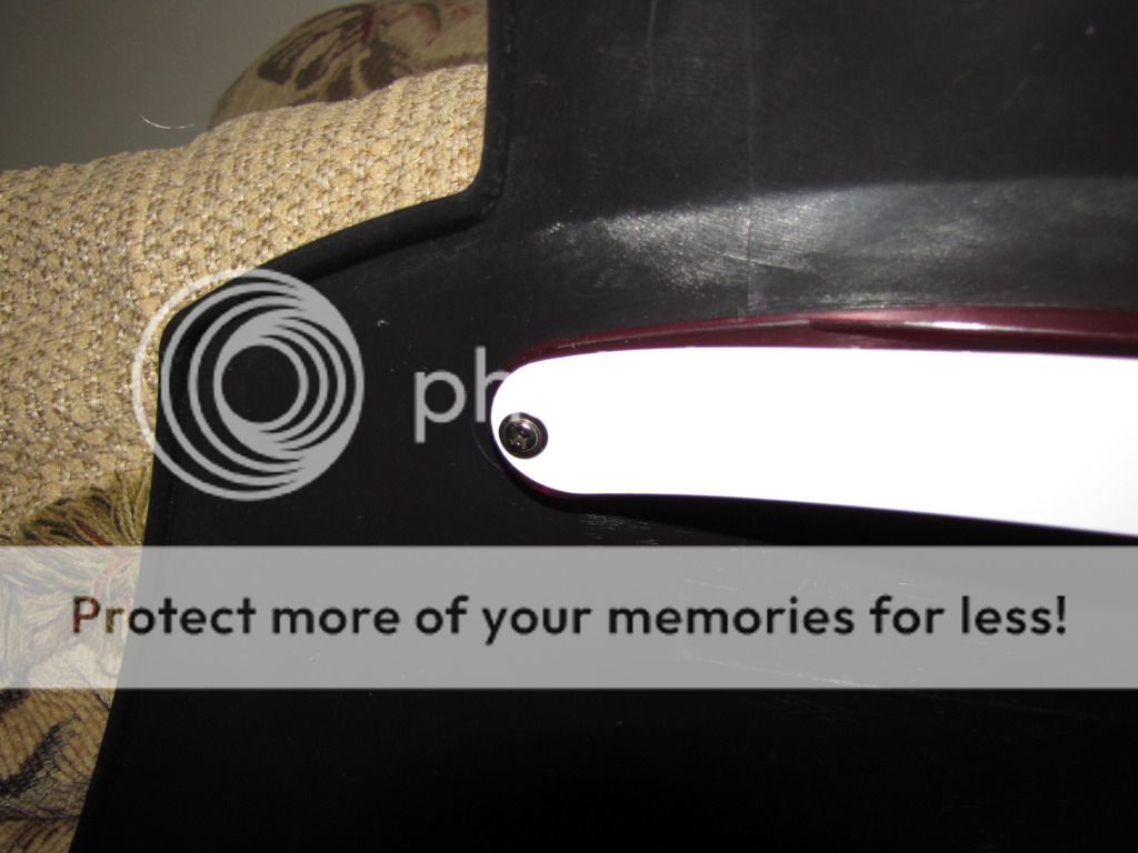

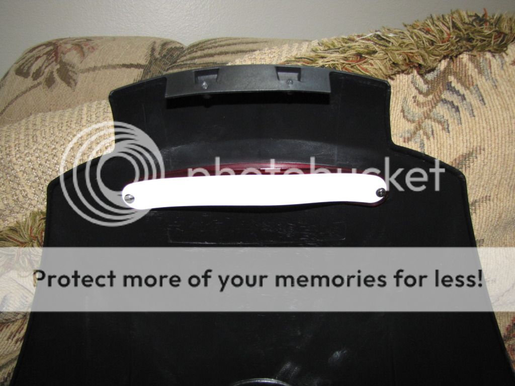

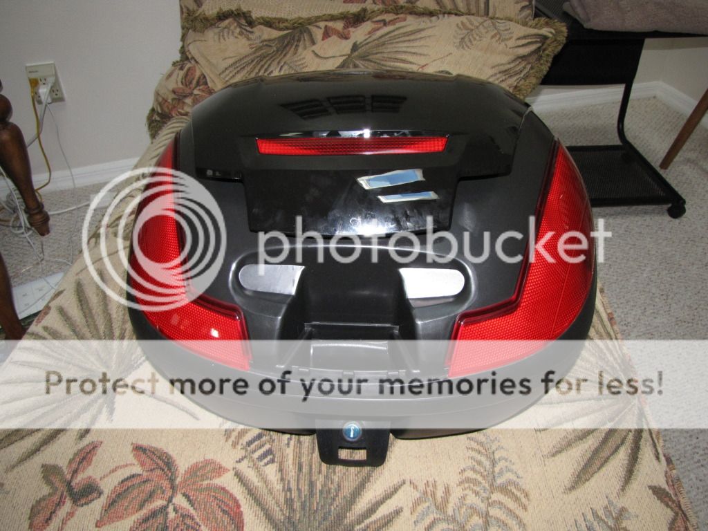

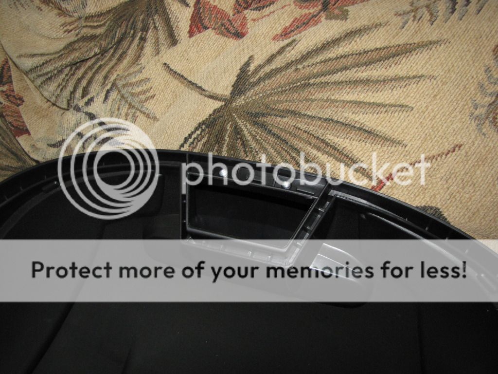

While I wait for the mounting rails, there's NO WAY I can leave this thing alone.
With custom fingerprints added, this is the view of the top case, from the rear.
That top reflector.... it looks waaaay to much like a brake light...  I'll have to fix that!
A total of 4 screws has the top case in pieces... no complaints, it made my work easier.
These two screws allowed the top cover to come off...
Like so.....

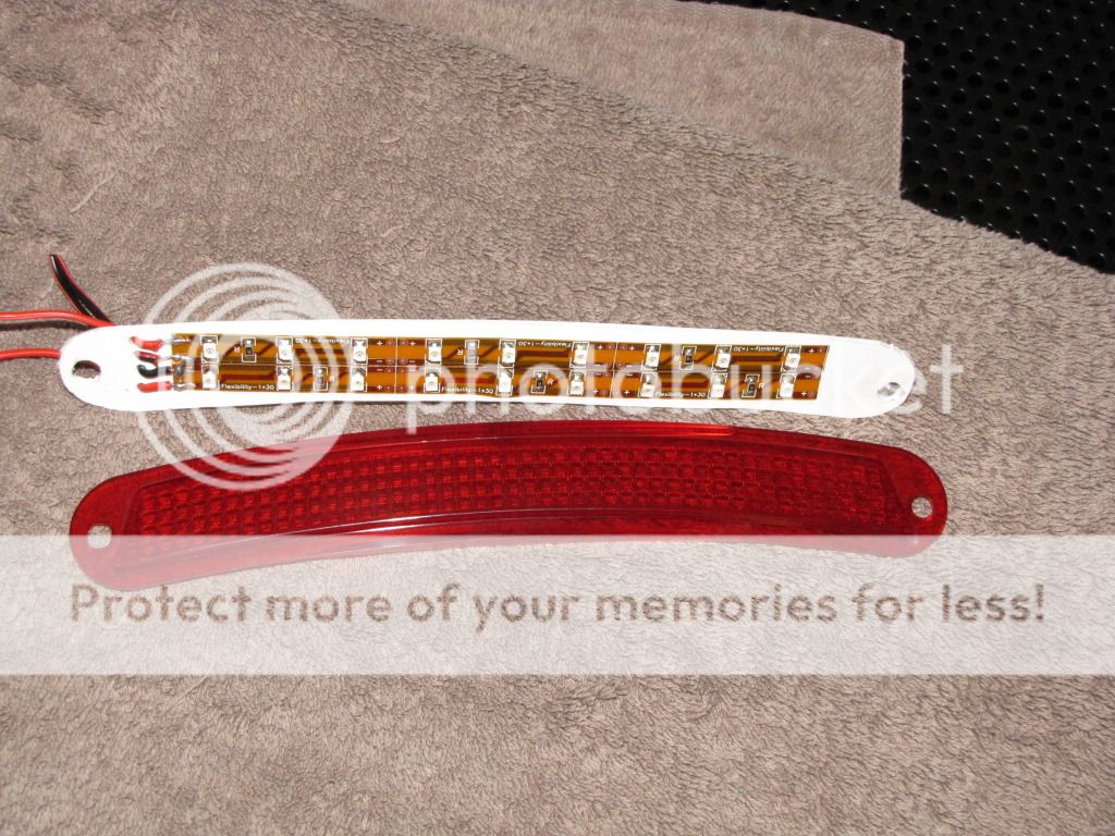

Then two screws held the new brake light lens in place with a piece of somewhat reflective white paper
behind it.  I removed those 2 screws, and the lens popped right out!

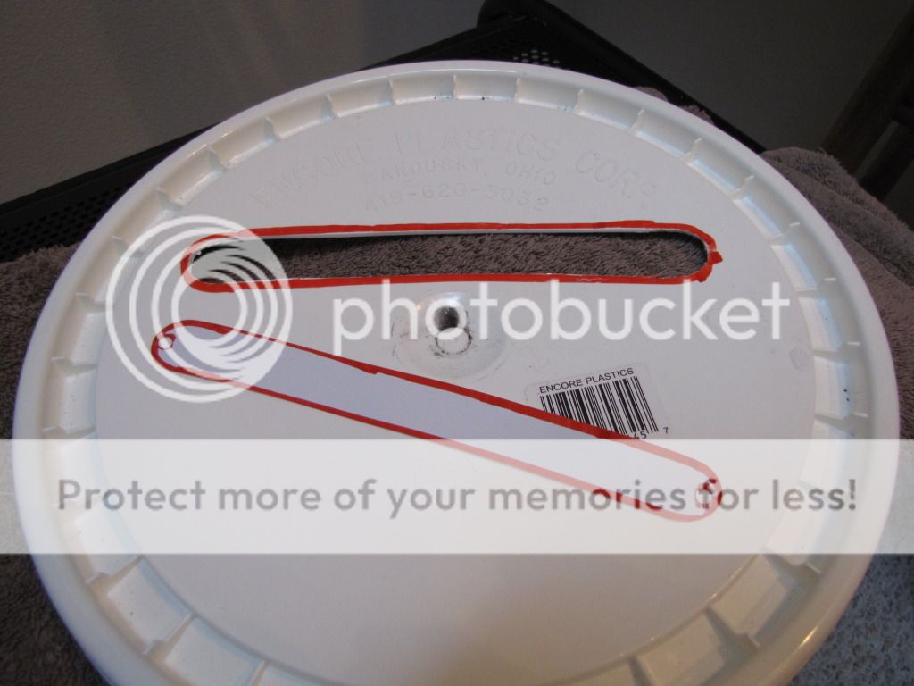

That piece of white reflective paper became a template to make a rear cover.  I sacrificed a joint compound lid
for the material to make the cover.

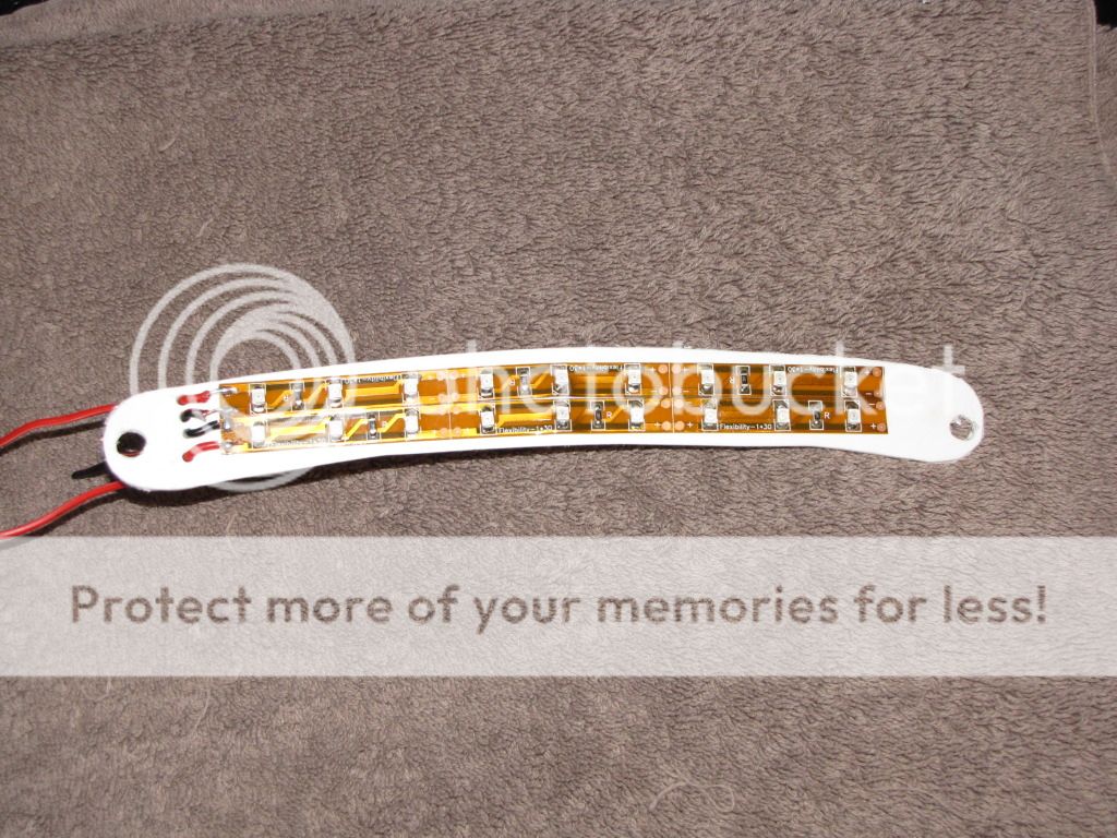

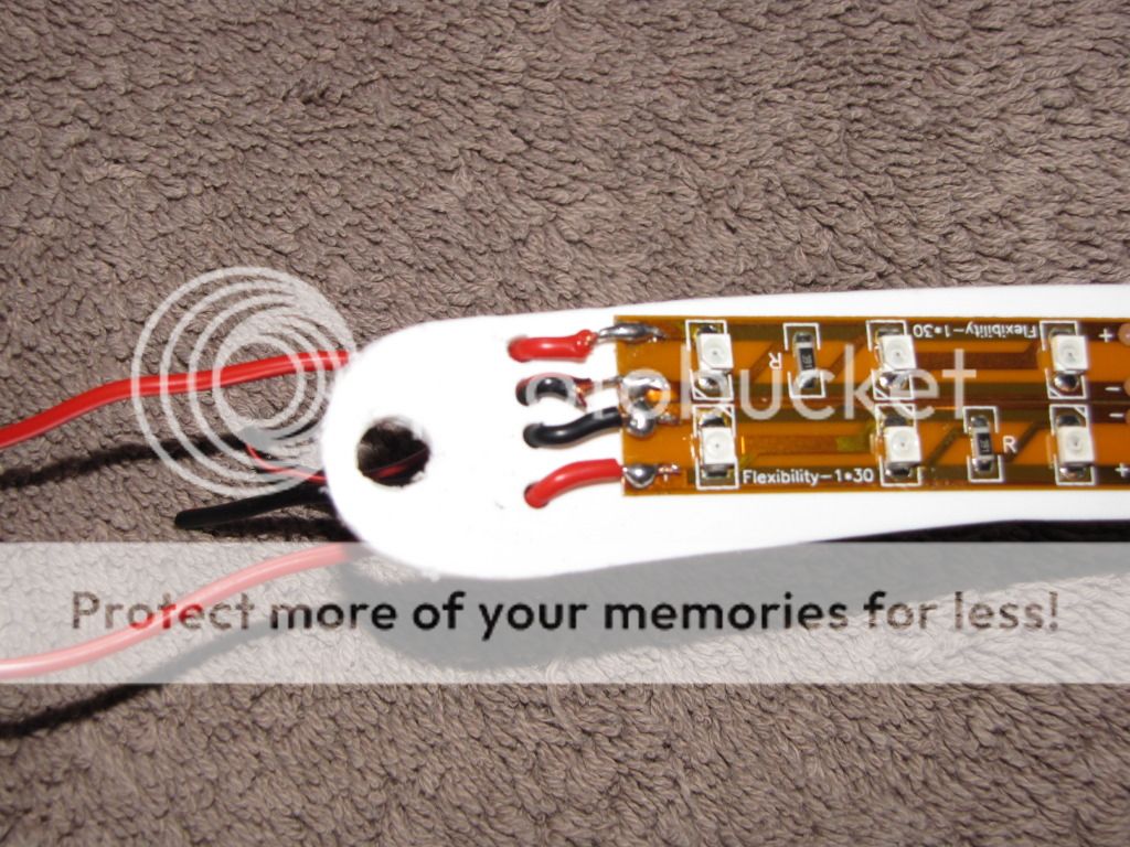

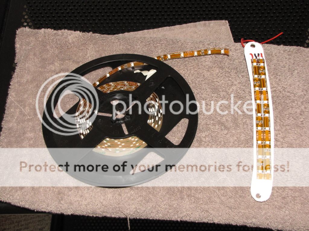

After doing some fitting, and measuring, and soldering, I fabricated this LED unit to attach to the lens.
Here's the type of LED tape I used to make the LED unit.  It's adhesive backed, and can be
cut into 2 inch increments.  I did have to solder leads to each strip, then run the wires through
the back.  I then spliced them (soldered) from 4 to 2 leads.
The 2 pieces of the new brake light:

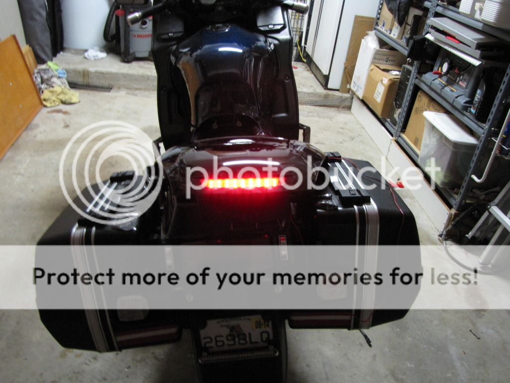

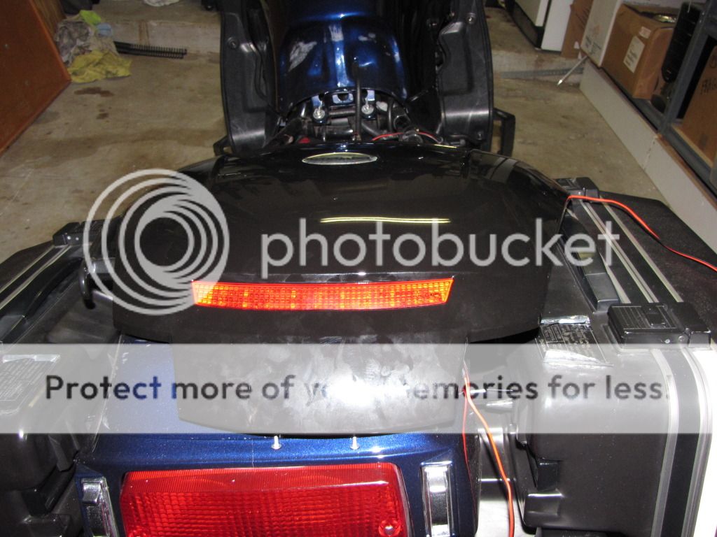

Remounted the brake light into the top cover, and brought it out to the garage to test:
Viola!
Next, I need to weather proof the whole thing, so I will run a bead of clear silicone around the perimeter, and over the
where the wires come through, and that should keep things nice and dry.
Next....  I'm putting in a 'cargo light' so I can see what I'm gettin at in the dark.
I'm also looking at trying to light the sides up, but I'm not too sure that will happen.
(I still have more of this red LED tape :-[  Been sitting around since I did the Amp board on
my last car)  I have to figure out if I can keep the LED strips dry.  Stay Tuned!

The end result, with the lens in place looks like this:
A BONUS!!  The shape of the Top case actually makes the side markers visible from behind!
Now it's time to route wiring, and install a switch for the cargo lighting.  I'll likely use some foam to cover the marker
lights on the inside, before I put the top liner in.  The liner will help hide wires, and protect the cargo a bit.  All the wiring runs
through the cover. (Convenient!)

You said you were waiting on rails to get to you so you could install your new trunk, any chance those are the Murphs top rails?  I've been trying to get some pictures of what those might look like,  but can't find pics anywhere.  If you are using the Murphs rails, would you mind posting your final install so I could see what the set up looks like?
Yes, they are Murph's Top Case Rails, though I'm buying them from another COG member.
I'll be happy to snap a few pics for ya, both off and on the motorcycle, and with the top case.
Murphs Top Case Rails:
Here they are on the bike:
I'm in the middle of working on the top case.  Once it's done I'll post up finished pics, mounted on the bike.
Hopefully in a day....two tops.   :great:

Hmmm, that doesn't look right.. Shouldn't the rail risers be on the outside? Now I don't know what your mounting plate looks like, but on my Shad plate,
the rails are just the opposite from your mounting..
AMA# 1088783
2012 C-14  'Rudy'
  • Stayin' for the people....
  • Posts: 3956
Re: Considering a Top Case +
« Reply #22 on: January 16, 2013, 01:31:08 am »
The Shad top case would probably use the set up below....
BUT.... I have a cheapo case.... that doesn't fit on that set up...
IF I turn 'em around like I have originally pictured, the mounting plate lines up two holes...
... and I can put make a piece of steel to go across the back (view from below).....
Really wish I had a Shad Top Case, but I don't.  These rails will still provide a sturdy mount
for the Cheapo mounting plate, and require very little additional work.
