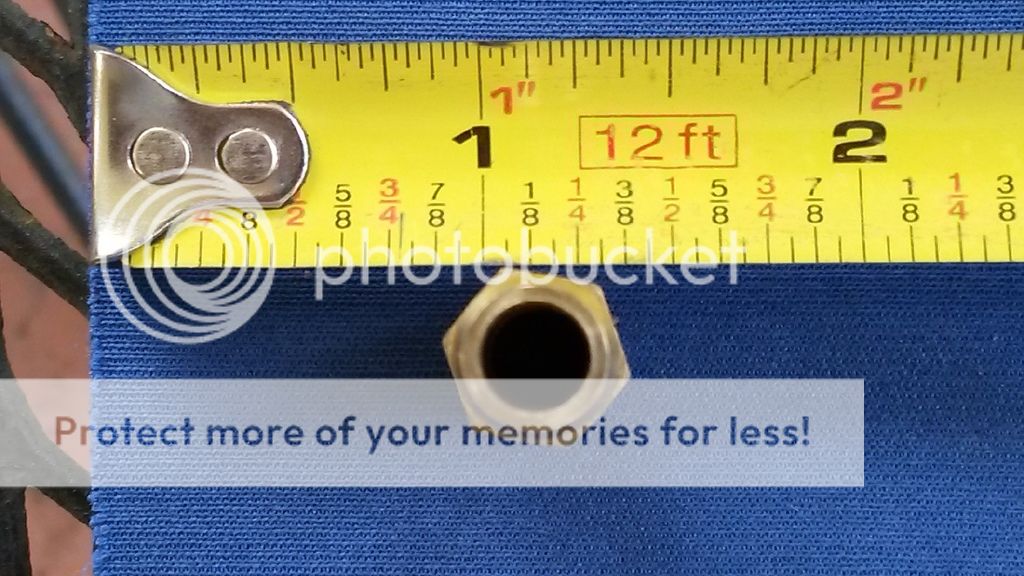

Basically you have:  90 elbow -> hose -> quick connect -> hose -> fuel filter -> hose -> valve -> hose -> quick connect -> hose -> fuel rail.
That is a bit more involved than what I had in mind.  I was thinking:  petcock -> hose -> fuel filter -> hose -> valve -> hose -> fuel rail.

I can redline the bike at anytime with no issue of fuel starvation.
Cogwheel...
For arguments sake:
Figuring we get, on average, 40mpg. RPM's vary, but that's approximately 3.2oz per minute at 60pmh.
Guestimate that there's 2oz in each fuel bowl, we'll put it at 6.4oz total to make it easy to work with the number above.
There's about 2 minutes of fuel in the bowls at a reasonable 40-50mph RPM range.
1/4" line, unencumbered by any kinks, clogged screens/filters, changes in direction will flow .279 gal per minute at a 12"/2" drop+=35.7oz per minute. Drop the drop to 1" and you're down to 15.5ish oz per minute.
Now, add in any restrictions, flow interruptions (bends, kinks, smaller orifices), things get iffy.
Using those same calcs, your 1/8th orifice will flow 3.968oz per minute without any interruptions.  Why 1/8"...I have 1/4" fuel line on mine? (check the specs on your valve) Gravity and flow don't like restrictions...like that valve, like that 1/4" "T", or 90, or even the interior dimensions of the check valve...you're probably down to 1/8 (that valve has a 1/8" ID), at most 3/16". And while that may work on a pressurized fuel system, this ain't one.
Gravity is your friend only as long as it can do it's job without interruption. Any interruptions just means it needs to start falling again, and velocity is tied to oz per minute.  While that valve 'might' work at normal cruise speeds, long bouts with Rev'itus, any other restrictions in the pipe, carb work, even less than a full tank's worth of head pressure may reduce your ability to run full out for an extended period of time. Not many of you are going to suck your carbs dry running full out for 2min, but they probably ain't gonna refill fast enough to do it again.
All this before coffee. Now, if you'll excuse me...I need to caffeinate before this type of thinking continues and someone pays me to think this way.
Don't know so much about the math involved - other than it hurts my head, but I am taking a simpler approach.
1.  I have an existing fuel line that works just fine, so I am assuming the math for it is correct in as much as the ID is just fine.
2.  I will remove a section of the current fuel line and replace it with a mechanical pass-thru that has a comparable ID (5/16")
3.  The decline and path of the new arrangement will not deviate from the existing configuration.  I am simply replacing rubber for metal.  Nothing else changes.  Same path, same flow, no new curves or kinks.
I am simply not convinced that the fuel valve is going to reduce or restrict the current flow to the carbs.  Either way, I intend to find out, if for no other reason than my good friend Doug took the time and effort to help me resolve the threat of a hydrolock.  Basically, it is costing me nothing but my time.
As far as an electronic cut off valve not preventing a hydrolock.....
From what I understand, 2 failures have got to occur for a hydrolock condition to exist:  1) petcock does not shut off correctly, and 2) a carb float is sticking.  With the addition of an electronic cut off valve, 3 failures would have to occur.  If I am indeed that unfortunate to beat the odds and have all 3 failures occur at the same time, well you know what - I'm toast anyway.  It just wasn't in the cards, is all.
At any rate, it's going in.
It's not that I am opposed to overflow tubes, it is more a matter of 'least resistance'.  A free prevention device installed in 2 hours has a lot less resistance (and down time) than dismantling the carb bowls, shipping them off and paying the cost of modification.
Personally, I don't want to even have to mess with this.  I don't know how much overflow tubes installed by the factory would have increased the selling price of the bike, but I am sure, now knowing the bikes reputation, no one would have objected to the extra $30-$40.  This simply was not the place to cut costs.  But, it is what it is, and no matter what, the world will continue to spin.  In the meantime, I will take measures to protect my beloved bike.
Still, I simply don't see the concern about constricted fuel flow.  Looks like a big a** hole to me - math or no math.  Coffee or no coffee....

From here:
Quote
http://www.afcvalves.com/mod111.html
This:
Quote
Orifice size .156” for adequate flow of all fuels
Not saying it won't work, but you're not even to 3/16th" tube size INSIDE the solenoid.
Peace of mind for the cost you have in it though, and depending on your driving style, it could easily be win/win.
You may run all day at 55 without problems, but full flow at high RPM's for extended periods of time just won't be there. You'll eventually clear out the bowls with just a trickle coming in.
(oh, this one: http://www.afcvalves.com/mod121.html might be a bit better, in either .250  or 5/16th")
