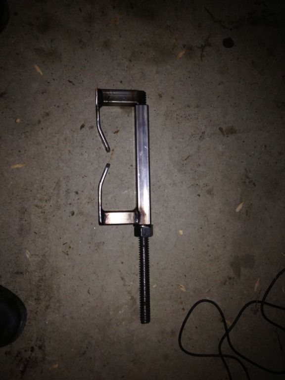

Thought I would share my Sensor installation.
May take More than one post sorry. :)
First the tool.
Here is the tool I was thinking of using costs about $45.
I also thought about this tool costs about $60.
In the end I was looking at the last tool and thought hey I can make that.
So I made something close,
But I just used ACME all thread as it is a little courser than standard all thread and makes for good clamping.
See Next Post.

Next I just put the bike on the center stand and remove the valve core to let the air out.
Then put the clamp on.
Now I only needed to pull the bead over to one side far enough to clear the valve stem for removal and sensor installation.
So I put a 2x4 on the other side of the clamp to prevent the bead on that side from moving and allowing the bead on the working side to be pulled all the way across the rim.
Then Crank until there is enough clearance to remove the valve stem.
See next post.

Awesome!
I posted a little back asking if that could be done, was universally told " No". It seemed to me it would work just as you did it it.
Everyone said it's simple to just pull the wheels and do it that way. But for me not having a means to break the bead and not having a means to hold the wheel, I thought it would be easier for wheel to stay on the bike.
Interested in loaning your tool if I paid the shipping?
Ah yes no doubt the Dark Side of the forum, I have seen this offten, The nay sayers.
Yes I will loan you the tool with the only stipulation, That you post your results in this forum so that the Dark Lords my see the error of their ways. Oh and shipping cost also.

That tool would be very helpful to break the bead for a tire removal also.. Was the tpms/valve install tough getting into the rim? Did you use a normal tire valve install tool that attaches to the threads of the valve and yank?

Bob the tool is actually made to break the tire bead I just used it a little different.
