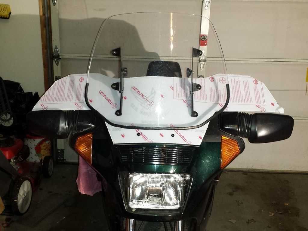

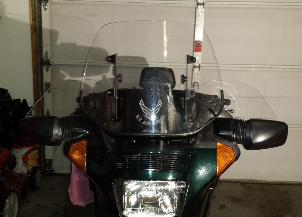

Okay...  Here's what I came up with.  I purchased a 4' x 1' sheet of polycarbonate online.  It was only $11 something, but because of the size they charged another $17 something to get it to me.  So investment: just under $30.
I started out cutting a template out of the shipping carton it came in.  Got a rough idea of what I wanted, and then traced the cut line on to the protective sheeting of the poly.  This stuff cuts very nice; no splintering.  I used a recip saw.  It took me about 7 cuts total to get it how I wanted it (or at least close).  Here's a picture from the front with the protective covering on so you can see where the deflector is.
Here's a shot from the back.
And here are front and back views of the final installation.
Pictures never come out very well in a garage at night, but you get the idea.  I won't have a chance to test it outside for a few days yet because an issue with incompatible thread patterns made it impossible for me to complete my 4 pot calipers changeover until a new double banjo bolt arrives (subject for another post). Riding without front brakes... not a good idea.
I think it will work out okay.   :whoo:

Still waiting on the banjo bolt, so I messed with the extender again.  I shortened the wings, and rounded the edges (good call, cra-z1000).  I'm pleased with the way it came out.  Keep in mind, I am not a "work with my hands" guy, and am a truly mediocre mechanic.  So anything that works out close to what I tried to do is a pleasant surprise!

I've finally had some opportunities to ride in colder weather with the new extender.  I am very pleased with it.  Both the hands and arms are better protected from the breeze.  There might be just a touch more shimmy when you get up around 90 mph, but wind and truck buffeting have never bothered me so to me it is well worth it for the extra cold protection.  I have mine secured at six points, and its removal in spring will only take about 5 minutes.
