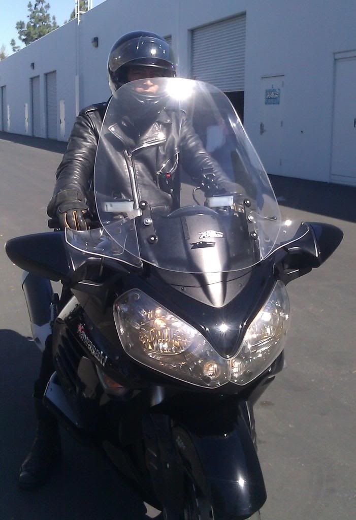

This is still not the final design but its close. I believe that this is prototype #4. The first prototype was a modified k1200 screen to have a good baseline. He took his K1200 screen, added wings to make it wider and sent me off for testing. I did notice an improvement but it wasn't quite enough. Airflow was smoother but it was still noisy. Wind was hitting me right in the face so it still wasn't tall enough.
The second design was worse than the first so he didn't even bother having me test it!
The third design was very promising. Airflow was markedly smoother. A back to back run with the stock screen and prototype #3 showed a huge improvement in wind and turbulence control. Still a bit noisy as wind was still hitting me in the face but MUCH quieter than stock. At this point, he installed two other items. Hand deflectors and a laminar plate that attaches to the dashboard. The laminar plate was supposed to direct the air up the backside of the windshield and create a smoother blending of the air. Well.... That didn't work out that well. It seemed to direct more air to me, lowering the airflow to below my face. The Hand deflectors were tried with the stock screen and the Prototype #3, With the stock screen, the deflectors worked brilliantly. I noticed a larger bubble of calm air around my hands and up to my shoulders. With prototype #3, it didn't seem to make any marked difference. I think the screen is so good, it doesn't need them.
Prototype #4 is the same as #3 but taller.... we have a winner!! Now I have my calm air! The testing for #4 was done in the span of a few days. Unfortunately, the wind picked up in SoCal and i'm sure it biased the testing. I did a run with the stock windshield to compare. Going eastbound on a freeway, I was in a very noticeable headwind. I was wearing my Bell Revolver helmet which is notoriously noisy. I did about 7 miles eastbound and I was doing about 75mph. The wind noise and turbulence was so bad that my ears hurt. When I turned around and headed west, the wind noise was much quieter that normal.... the tailwind was keeping things calmer and quiet.  Next, prototype #4 went on. I get on the freeway and was disappointed... no headwind. Crap... the wind is very quiet and now I am doing 85 because of how calm it is... after a while I start noticing a few gusts of wind and a little turbulence... then I realize... the wind didn't calm down, the windshield was just THAT MUCH BETTER! I was ecstatic. On the westbound leg, things were so calm and quiet, I was doing 90 mph without realizing it.
Paige let me take my bike home that day. The next day, I took the bike to work. On the way, I did about 110mph, sitting straight up in comfort. I don't usually ride like that on my way to work but I wanted to see what the windshield would do at that speed. It performed better than expectations.
One bad: The taller screen seems to bounce around quite a bit more than the stock screen. It seems the mounts have a lot of flex in them. I check this forum and it seems that others with different brands of screens have the same problem.

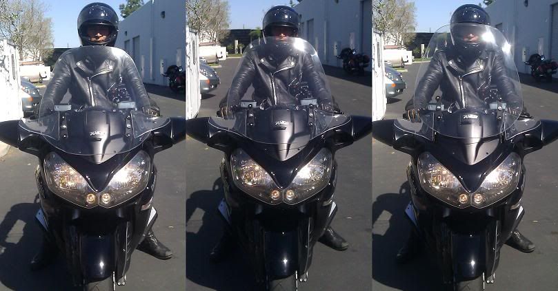

Prototype #4 vs Final design
Not sure if it is very noticeable in the pics, but the Aeroflow windshield has a lip on each side of the windshield mount. This lip helps to direct airflow and it also acts as a ridge to give the windshield strength. The final design has a longer ridge and is more parallel to the windshield mount. I believe that Paige will offer the Windshield at different heights to please different riders and their needs.
here's a few more pics
FRONT VIEW WITH SHIELD AT DIFFERENT HEIGHTS

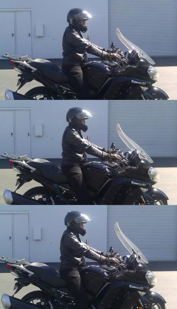

SIDE VIEW WITH SHIELD AT DIFFERENT HEIGHTS

What hand wings are those Jose? Same mfg as the shield??

The hand wings are made by Aeroflow as well, I explained in the text above (I know its long) that they seem to work great with the stock Connie shield but add little to the Aerflow shield. The Aeroflow shield seems to help cover the hands and shoulders good enough not to require the wings.

On the side view picture, it seems when the shield is all the way up, you are looking through it. I like to look over it.

Uhm, thats why you have the little switch to lower and raise the shield!
Actually, with my Baldwin seat (aprox 1 inch higher than stock) and me sitting straight up, at speed, I am still looking above it when the shield is fully raised. At about 80mph the windshield mounts flexes and the shield tilts back a bit. The windshield itself does not flex, but the stock kawaski mounts seem to flex a bit. That is why (as I explained earlier, the shield moves with the wind at high speeds). I think (from reading on this site) that is a normal occurrence with larger windshields.
At 75-80 mph I seem to have the windshield about 3/4 of the way up and it is very effective. I too like to look over the shield, I did that with the stock shield fully raised. The difference now is the noise levels and buffetting are far, far less than with the stock shield. On the 2010s and up, there is a setting to automatically raise the shield to a preset setting. I now set it to 3 (out of 4) which is approx 3/4 raised. I can look over the shield and still have good wind protection.
edit to add:
I believe he will be offering the shield in different heights. Besides, when it rains, its nice to be able to raise the shield as high as possible!

Also, forgot to mention.... the headlight guards are Aeroflow as well...

Somehow it kind of looks weird to me, looks like an open Oyster or some kind of shell to me, not putting it down, but looks weird from the front of the bike, i just bought a cee bailey and it follows the bike lines, just my opinion.... works great for me and a few more people here in the forum... just my two cents  :-[

And that's why its nice to have choices.
For me, I want a shield that gives me smooth, quiet air first... looks are second. But I don't mind the looks of the Aeroflow shield. And after riding behind one and how quiet it is, I can't even remember what it looks like!
