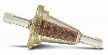

having used on bikes, many permutations of fuel filters like this
and this
I would never again use a plastic body filter, every one I've used failed within 3 years, and dumped fuel during it's failure...
That said, I don't use any external filter anyways, so if I did, it would be the glass/metal construction like in the last photo..
as for the shutoff valves, everyone says "High Flow", when in reality, how much flow can you get, thru a barbed fitting, with an I.D. that allows a 1/4" hose to connect to it...?
not saying it isn't enough flow, just making a point that the flow i.d. is "just enough" not High Flow... :rotflmao: :rotflmao:
I am also very impressed with the cheapo shutoff valve I use on my Snapper mower, really cheapo one, that has lasted 5 years now (and I installed it because I had a float needle that didn't want to seal, but it was an all metal float needle and seat... like a Mikuni carb in old days had... how did those work soo well? hmmmmmm...)

you get 1/4" diameter inner port. that's full port in the valve world. std port is quite a difference.
sintered bronze cone element filters are an issue with rusty sediment, they will pack in with fine particulate and not flow. the flow rate actually sucks even 100% clean especially on a bigger line. use a screen filter.
ive seen a glass filter break, and the result was not pretty. ill never use one on anything. ever.
this filter:
https://www.milfordpower.com/R10423-1-4-Line-90-Degree-Fuel-Filter-with-Poly-p/r10423.htm
please note: 5/16 OD. 1/4" id. listed as 1/4" filter. plenty.
have run there for many years. replace every 5 or 6.
yeah...

Internal filters seem to distort at base as they age and allow fuel to bypass on the three tanks I have inspected. I have broken a glass filter on road trip. Had o-ring seal issues too. To hamfisted for glass I guess.
Never had an external plastic filter fail. Have tried a few that did not flow well new however. Some just are too restrictive for gravity flow. I always check by observation into a gas can.
I have a 5/16 external petcock. 3/8ths are available as well. 5/16 th flows fine.
As said prior, like the whole affair, filter and tap in plain view. Something reassuring in light of hydraulic lock issues on these old bikes. Also allows inspection of fuel debris at a glance.
Like tires, fuel filters and manual taps are a luv affair where the beauty is in the beholder perhaps would submit....he he!

The Petcock arrived!!  / Hole spacing is far too narrow, and hose nipple on wrong side for use on my old dirt bike.  :-[
I'll send the supplier a note and ask if they can help us.
UPDATE: The supplier said that none of the petcock's he has; have the correct bolt hole spacing..
PS: I like Lee's inline idea.
           That way, I can't forget turn the gas off, but I could turn valve off and run gas out of carbs when parked for long term.....
FWIW - more than one way to skin a cat:
