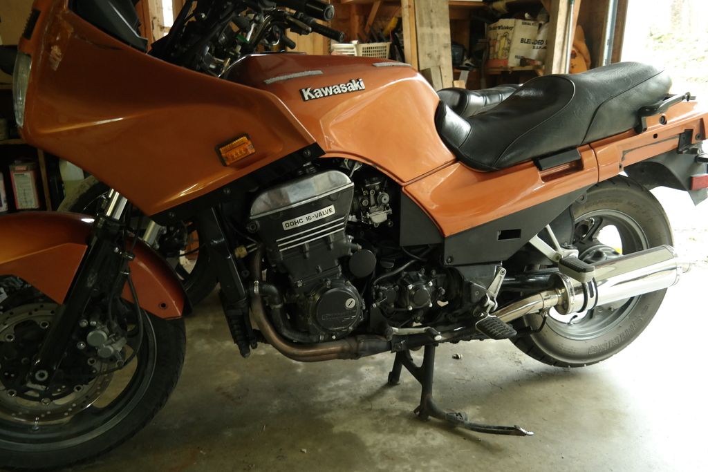

I ran mine without the lower fairings for seven years or so:

Where did you get the black strip? Is it ABS or another material?

In my case, I formed the lower trim strips from strips of aluminum and painted them black.

For me it was a few things. One, I had just completed an engine conversion to the ZRX1200 engine and I wanted to keep an eye on things for a while. Secondly, ease of access to things like oil drain and filter was a plus. Also, the ZRX engine was designed to be admired and I think it enhances the look of the motorcycle.
It did result in more heat flowing into the cockpit (worse in warmer weather). But it was not focused but a general incursion. Some may not like it, it didn't bother me much.
