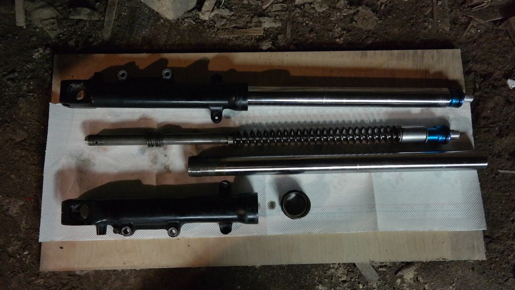

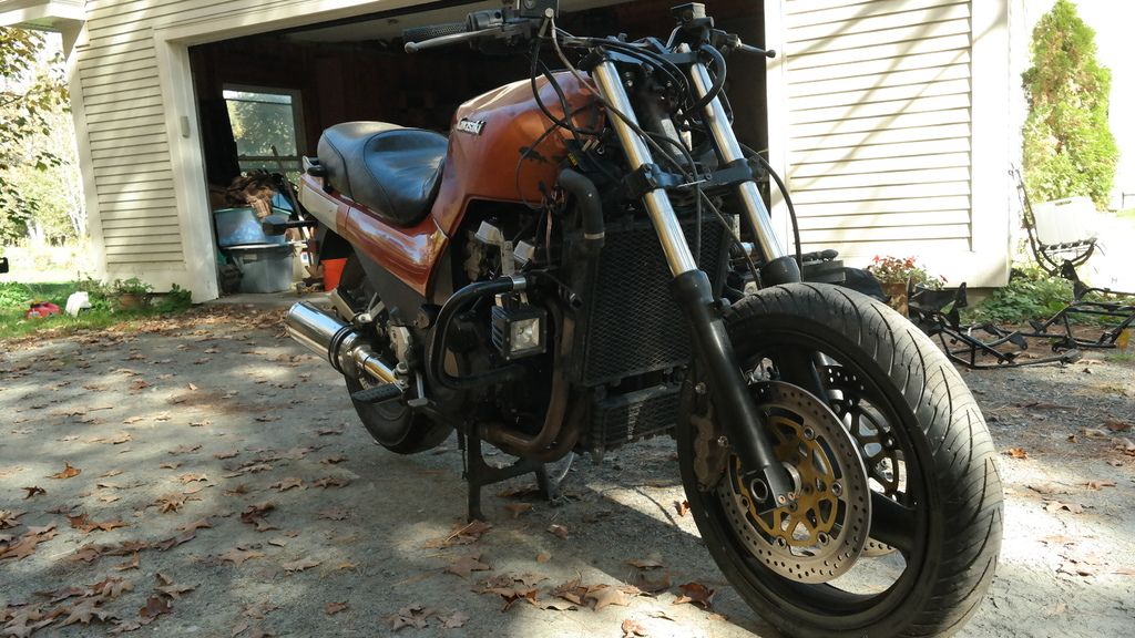

So a summer of collecting parts came to fruition last month, and finally got all the ZRX 1100 parts together in the same room.
This was taken afterwards when I had to replace another broken fairing stay. The first thing you might notice is how much beefier all the parts are, those are 6-piston calipers on each side. This is the equipment these bikes should have came with, "shouldabeen"? Last piece that I need is an overpriced ZRX fender!

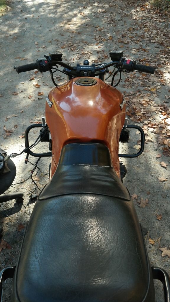

Side note: Since I do not run lower plastics, I was able to position the tip-over bars from Murph's in any orientation the hardware allowed. The lights are mounted with repurposed highway pegs off my Honda, god knows those death traps won't be sticking out the side of my bike.

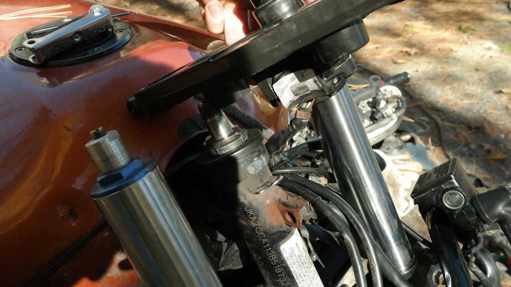

I think I could have gotten away with not grinding the whole steering stem lock tab off, ground lots off the ignition, but it still didn't seem to want to clear. Sorry Connie, it was for science!
Rebuilding the ZRX forks was not too tough, and easier to unscrew/screw together than OEM Concours forks.
Bars are Daytona-style with a "touring" pull back and rise of a few inches. Compared to stock Concours bars with risers, these are like riding a dirtbike.
Finished product is a different motorcycle. She looks similar, but the handling is night and day. Braking has no comparison to OEM. I even accidentally ordered a 110 size tire instead of 120, the profile is a littler narrower, but taller potentially. This may be the quickest Connie I have ever seen..
After upgrading to 36mm carbs given the full SISF treatment, I needed this bike to stop as well as she goes.
