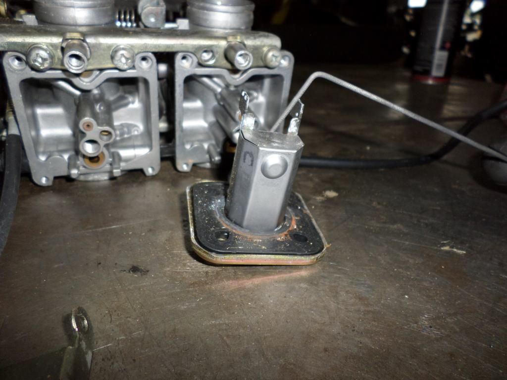

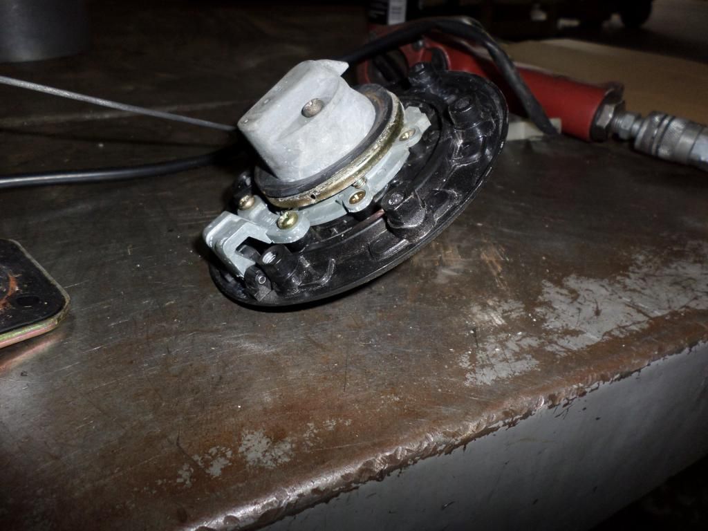

Let's start I got the gas cap opened by
pulling the gauge sending unit and a long rod
to the latch to work it with Eric playing with the key
tapping on it with a light hammer.
After a swim in the sonic cleaner lock work's great.
Sending unit after a swim.

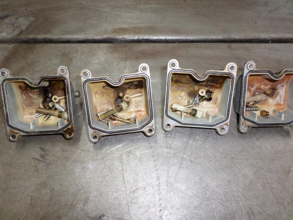

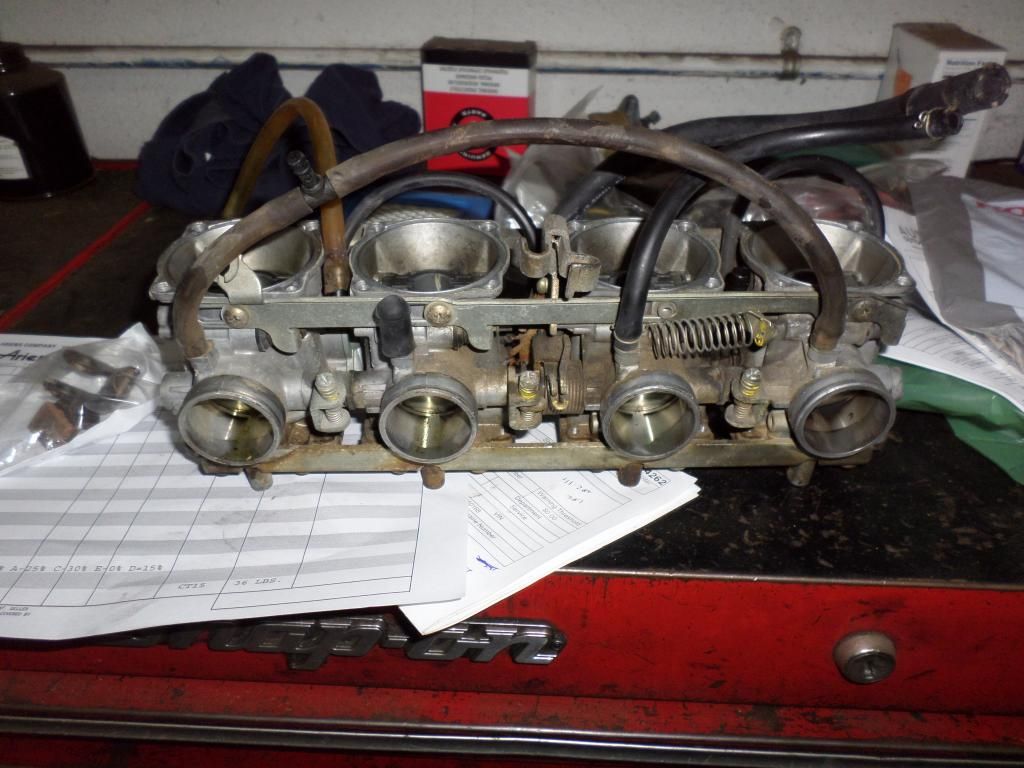

On to the carb's. as they came off.
Bowl's looked like this when I opened the carb's.

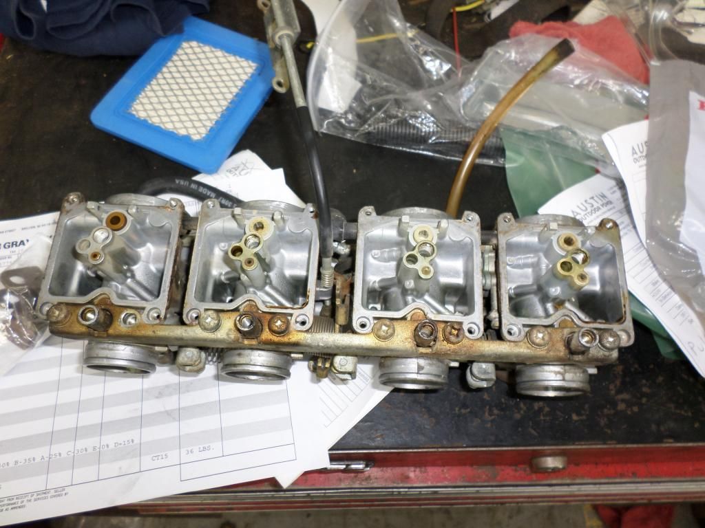

Carb. body's after a swim.

ya gotta love ultrasonic -  expensive, but sure does a great job! Steve

 Carb's got them back together and fire'd right up
idle'd nice and then number four go's to flooding needle ain't sealing..
Seeing as I just cleaned the carb's with no new part's so jump on
the hot rod and run to the local Kaw. dealer to see if they have needle's.
After tellin the kid who made this bike he look's it up they have four on the shelf at $40.00 each.
I told  him he's out of his f'n mind.
