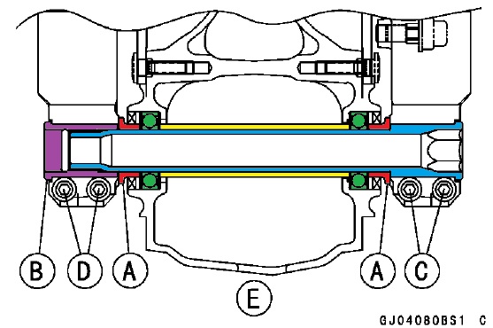

« Reply #39 on: March 15, 2017, 04:56:10 pm »
MOB, thanks for the info. Steel is good. I guess that a dirt bike (KTM) has weight issues, so they use aluminum. Just imagine the inner races being forces together, say .080". That's a lot of side loading of the bearings. Not good.
It doesn't work that way.  See the diagram below that I captured from the FSM and color coded.  The GREEN shows the bearings themselves and you can see the inner races.  The YELLOW is the sleeve that fits inside the wheel between the bearings.  The BLUE is the axle itself and the PURPLE is the axle nut.  The RED shows the two spacers.
As you can see, regardless of how tight you make the axle nut, you're not going to put pressure on the bearings, just the STEEL inner races.  Since the axle and the axle nut are aluminum, there is absolutely no way you can tighten this assembly enough to crush the bearing inner races.  The aluminum will give way long before the steel does.
Bottom line is that the axle tension does NOT side-load the bearings in any way.  They are free to turn at all times.

  • Posts: 8572
Re: What were they thinking (part 2, front axel bolt)
« Reply #40 on: March 15, 2017, 09:52:08 pm »
While I agree on the fact you can't crush the spacer, and other things as noted, which I posted, I will say this....
Go stick a.magnet on the axle... and the nut....  :-X
Let's put it this way, the nut will strip first.....  and also the reason I cautioned about leaving the nut clamped up tight when loosening the axle....
Oh, the rear axle and nut, and spacer, are all steel ... :great:

« Reply #41 on: March 16, 2017, 03:15:37 pm »
The part in yellow is Aluminum though.  At least mine was.
Over all I agree though.  May be better to loosen both the clamps and wrench hold both ends.

« Reply #42 on: March 16, 2017, 07:29:20 pm »
I thought we were talking about the red parts, the spacers.  They are steel.  I've never had the spacer out of mine so I'm not really sure.  But even if it is aluminum, it will be in compression vs. the axle which will be under tension.  I think the threads on the axle or axle nut are the weakest link here and will give way before any of the other parts do.

I'm sure most of you know this, but it is a good time to review. There is a precision cut piece of metal tubing between the wheel bearings. The purpose of this tube is to keep the distance between the inner bearing races constant and correct. Over torquing the axle bolt can literally squash this tube, shortening it, resulting in stressed bearings. Most motorcycles have this set up in both wheels. I have seen a local shop use an air wrench to tighten the front axle of my friends FJR1300. I had to use an air wrench on my axle tool to loosen it. Bad.
Thank you for sharing this, and it is used as a spacer, but some of your fears are a bit incorrect,
Using an air wrench on the axle nut is over kill, for sure, I would never use a tool for install that would prevent me from disassembling the parts on the road, using normally carried hand tools.
As far as "crushing" that tubular spacer, its simply not possible to do from tightening the axle nut, no matter what tools are used, the compressive strength of that tube is about 50x stronger than any force that could be generated by the mechanical force induced by the threafs on both the axle and nut....the threads would strip well prior to crushing the tube...
As for overtightening also, please note that each bore that the bearings are seated in, have an internal lip at their base, preventing over insertion... the bearings outer race will go solid against one during install, and when the second bearing is installed on the far side, it should only be tapped in untill it "bumps" the spacer tube, and you install the circlips that retain the bearings.
I hope this simplifies the assembly a bit, for those not familiar with the design elements.
I find the torque spec on the axles, both front and rear, to be somewhat excessive, but due to liability concerns of the manufacturer, they state them as "designed loading".
I've never had issue loading the axles on any bike using a 1/2" drive wratchet wrench, and a breaker bar on the opposite side, you can generate a lot of torque with those tools, more than enough to work correctly...
I also find that the suggestion of leaving the pinch bolts on the nut side of the forks tight, to hold the nut, so you can loosen the axle bolt, puts excessive wear on the actual threads of both the nut, and the axle, as the nut is now "clamped tight" and compressed slightly... If you only have one wrench, you can leave the pinch bolts.on the head of the axle tight to hold it,nwhile removing the nut on the far end.. I lube the axle threads with anti sieze, and coat the shaft with grease, and tighten the axle and nut prior to clamping the ends tight, and that is only after spinning the wheel and clamping the brakes on a dozen times to centralize the wheel between the forks...
These are lessons gleaned from 45 years of fixing bikes, with issues that were egsacerbated by incorrect procedures.
I will argue this point, from experience. I have not had the wheel bearings out of my C14, but have done many in other bikes, dirt bikes most often. These spacers are most often aluminum, and I have had to replace several due to deformation (shortening) of this spacer. If the one in a C14 is stainless steel, OK, tighten the living crap out of it. The axle is tightened about the inner races of the wheel bearing. The outer races are staid in the wheel by a boss on one side, a circlip or other keeper on the other. The inner race is located by the axle or wheel spacer on one side, the inner spacer on the other. I know from experience that I can ruin the spacer in the rear wheel of my KTM with a half inch drive socket and ratchet. Too much torque on the tightening of the axle is not a good thing. Keeping it within factory specs is safe.
Well, when you do get around to removing the spacers on either a C14, or a C10, stick a magnet against them....
