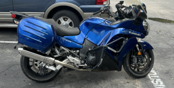

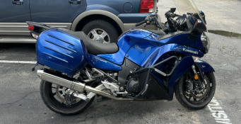

At the end of April I bought a new 2022 Concours. Since then I've had some money leave my possession.
  • Had Steve perform his amazing wizardry on the ECU - went with the Shoodaben Mountain Runner Premium flash!
  • Wired for BatteryTender
  • Added FuzeBlock
    • Removed the toolbox and 3D printed a custom bracket to mount the FuzeBlock in the toolbox location
  • Added Cruise Control
  • Added Top Block Tip-Over protection (crash bars)
    • Powder coated satin black so they match the lower black body work. Pricey, but I'm thrilled with how it looks!
  • Added TechSpec-USA Gripster Tank and Lowers Grips
  • Added Murph's Handlebar Wedges
  • Added Air-Flow seat cover
  • Added AST dual helmet locks to the bottom of the luggage rack
  • Added Mounts Lab Ram Ball stem mount - very nice hardware if you're looking to do a steering stem Ram mount
  • Transferred Zumo XT mount from my 2012 C14 and wired to FuzeBlock
  • Transferred Two Brothers Slip-on from my 2012 - bought and installed repack kit from RevZilla since I was swapping the muffler
  • Transferred Phil's Rack from my 2012
  • Transferred the Top Box from my 2012 and put on color matching paint panel
  • Transferred saddle bag liners from my 2012
  • Transferred Cee Bailley's XL windshield from my 2012 - had to buy a few parts from Ron Ayers Motorsports
  • After 600 mile break-in, changed filter, engine oil, and final drive oil
  • Ordered Road 6 GT's for the front and rear - will swap out what's left of the stock tires with the Road 6's at the National Rally (thanks Arrowlane for bringing a changer and giving up some of your time!)
I think I'm done with farkles......said every motorcycle rider at least 20 times.

If you want help spending more just say something.. lol

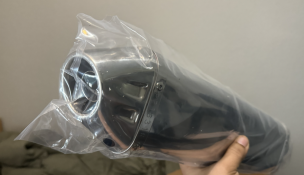

Made a longer bracket for the 2 brothers muffler. The T-Rex tip over bar was touching the muffler. After reading the thread about vibration from the muffler reaching the frame, I decided it was time to quit procrastinating and just do it. I haven't ridden it yet but expect a vibration I was feeling to be reduced or eliminated altogether. Even if it doesn't, it needed to be done to create space between the two.
